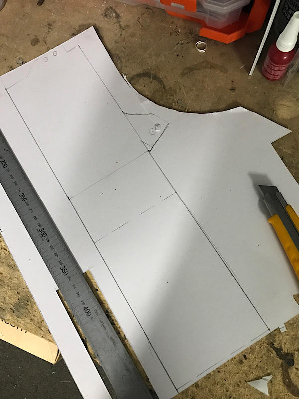

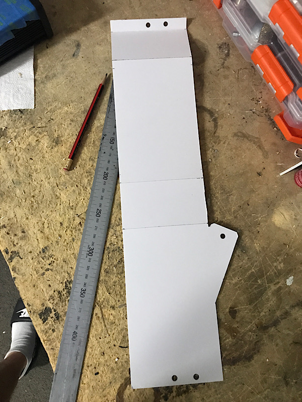

As you can see from the pics I used 3mm corflute to quickly create and refine the mock-ups before using 3mm PVC purchased from a hardware store for the final product. The 3mm PVC was eventually covered in carpet felt using heavy duty spray adhesive.

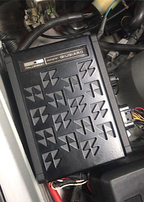

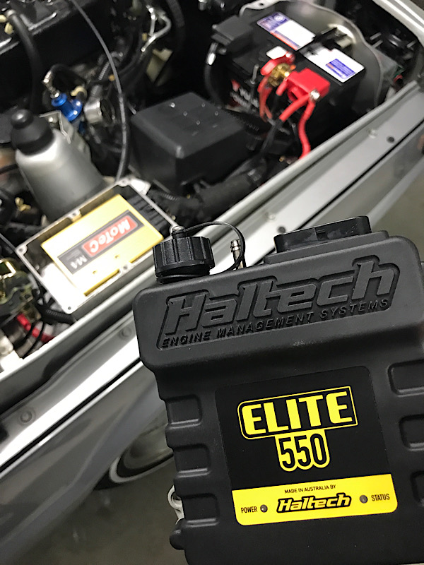

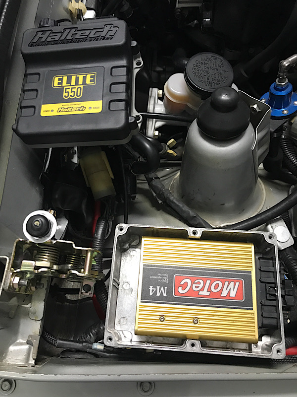

ECU swap time. I’ve upgraded to a Windows‑friendly Haltech Elite 550 — the baby of the Elite family, but easily powerful enough for this setup. The old MoTeC M4 wasn’t bad at all; it was a tough, expensive bit of gear back in the day. The previous owner reckoned it cost around $3K fully optioned.
Its downfall was age. DOS‑based software, no local tuners willing to touch it, and cold‑start quirks that changed with the seasons. After 30 years, ECU tech has moved on in a big way.

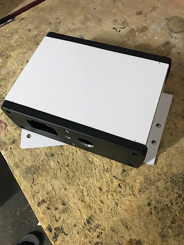

I scored a new but unused Elite 550 on Facebook Marketplace for a steal, grabbed a Polycase Enclosures from the US (EX-64 Extruded Aluminum Enclosure or SKU = EX-64-01), and then custom designed a custom bracket from laser cut 2mm powder-coated steel to mount it properly. A seperate Haltech Oxygen sensor controller module was also installed to complement the ECU.
Along the same lines as the outdated M4, I’ll be covering a new injector swap in my next post…
