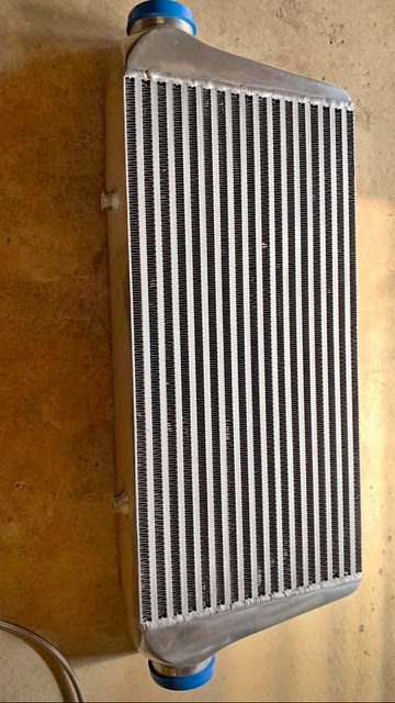

Now since my last post a couple of years ago I finally got my car back from my mechanic, had the car registered under historic rego, met some great like-minded friends, including Jeff Shein and his lovely wife who flew in from USA to see us in Sydney (nah only kidding). Today I sold the custom intercooler that came with the car when I bought it. It makes way for another much larger intercooler core measuring 600x300x100mm (KLS Power Spirit 5002, universal fit) that I just picked up. This monster cooler was originally test-fitted on a VL turbo pumping out over 800hp, but the owner went a different direction with another engine combo and the cooler never went in. And it only cost me AU$100. Can’t want to put this sucker in once I relocate the battery to the boot.

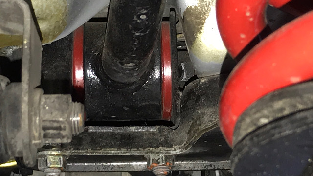

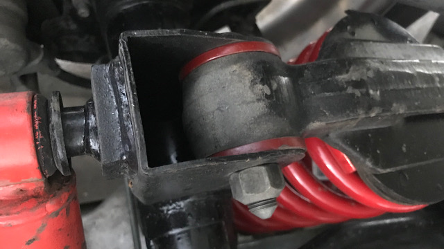

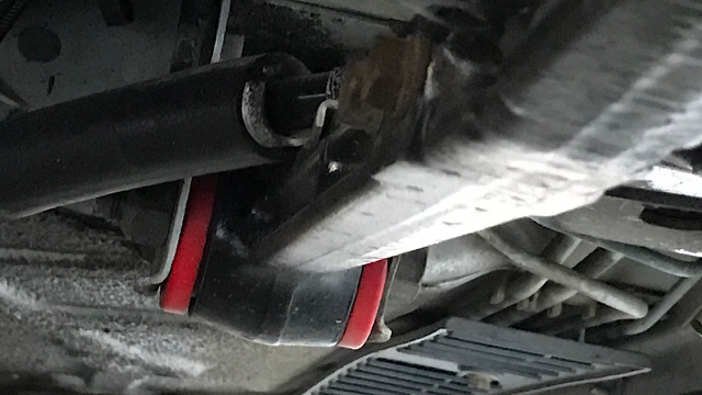

On the suspension side of things the nolathane bush conversion seems to be working well. Turn in and steering response seems sharper and direct. Anyway here are some pics of some red stuff. For anyone still interested I posted a full write-up in the Suspension section of the forum. Rear Lower Control Arm Rear Upper Control Arm

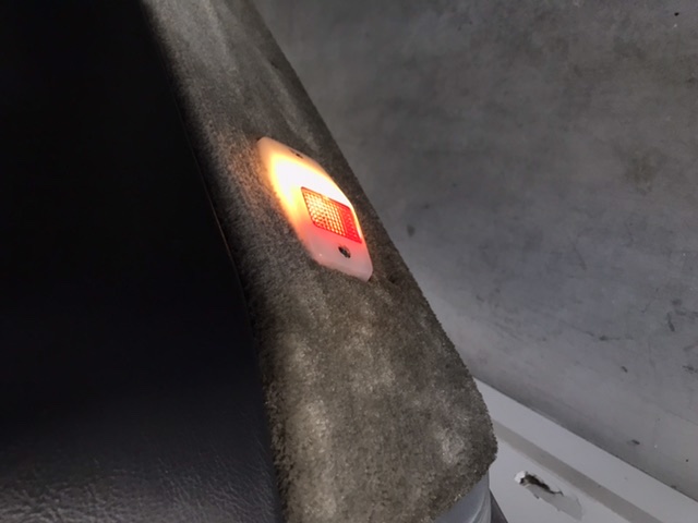

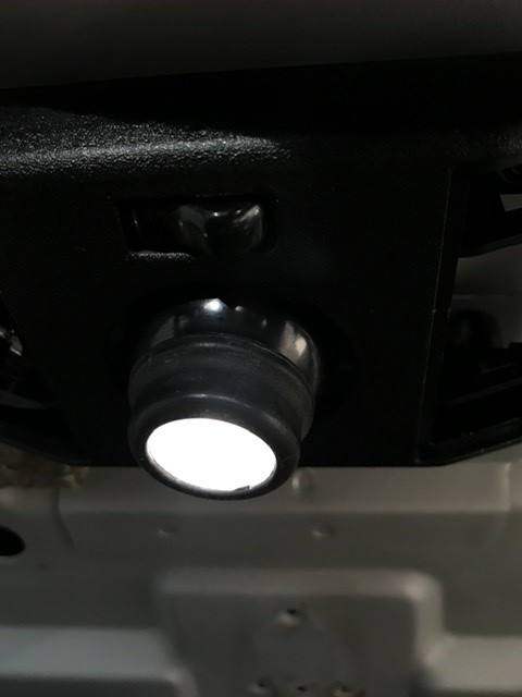

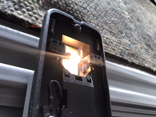

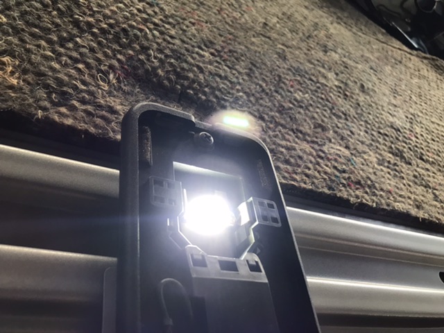

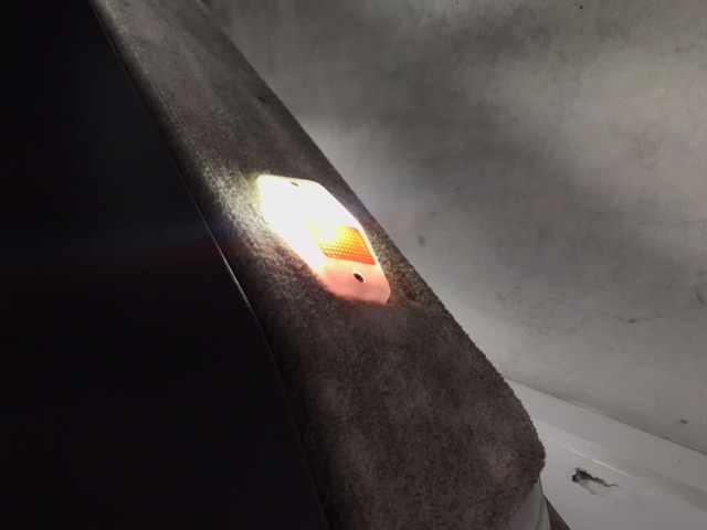

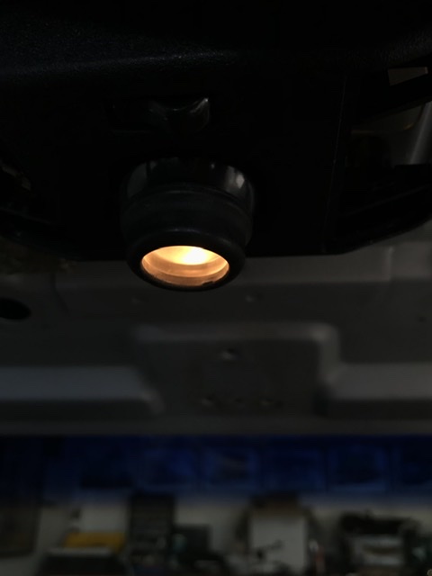

Moving onto LEDs now, and I’m navigating my way through replacing the standard incandescent interior lighting and rear number plate lights to LED. So far the number plate T10 LEDs that I replaced kept blowing my 15A fuse in about 3seconds flat. Has me stumped why, but I’ll try another set from another manufacturer to see if that fixes the problem. But the interior map light LED is a great and welcome change from the standard weak amber colour to the bright white light. These pics were taken in the daytime (in my garage):
Standard globe After LED For anyone else who is interested these are the ones I bought from eBay, but there are many other designs out there to choose from When the festoon LEDs and new T10s come in I’ll post more pics up.

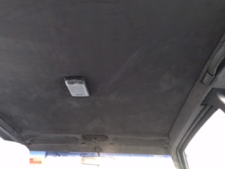

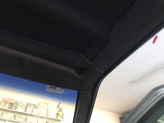

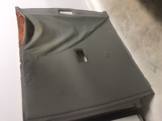

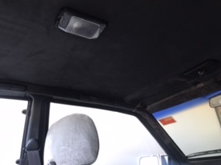

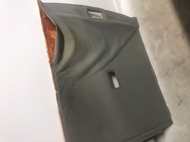

Installed the new headliner today, along with the same velour-covered trims for that premium look and feel. Headliner and trims were done by pro motor trimmer in my local area. I contemplated doing the work myself, but I’m glad I didn’t. Next job is redoing the sun visors, but in this case I’m pretty keen on chasing down better-designed versions than the originals that are way too thick and bulky. I hope to find a suitable replacement from the wrecker soon.

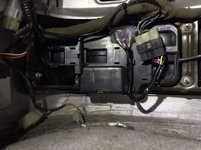

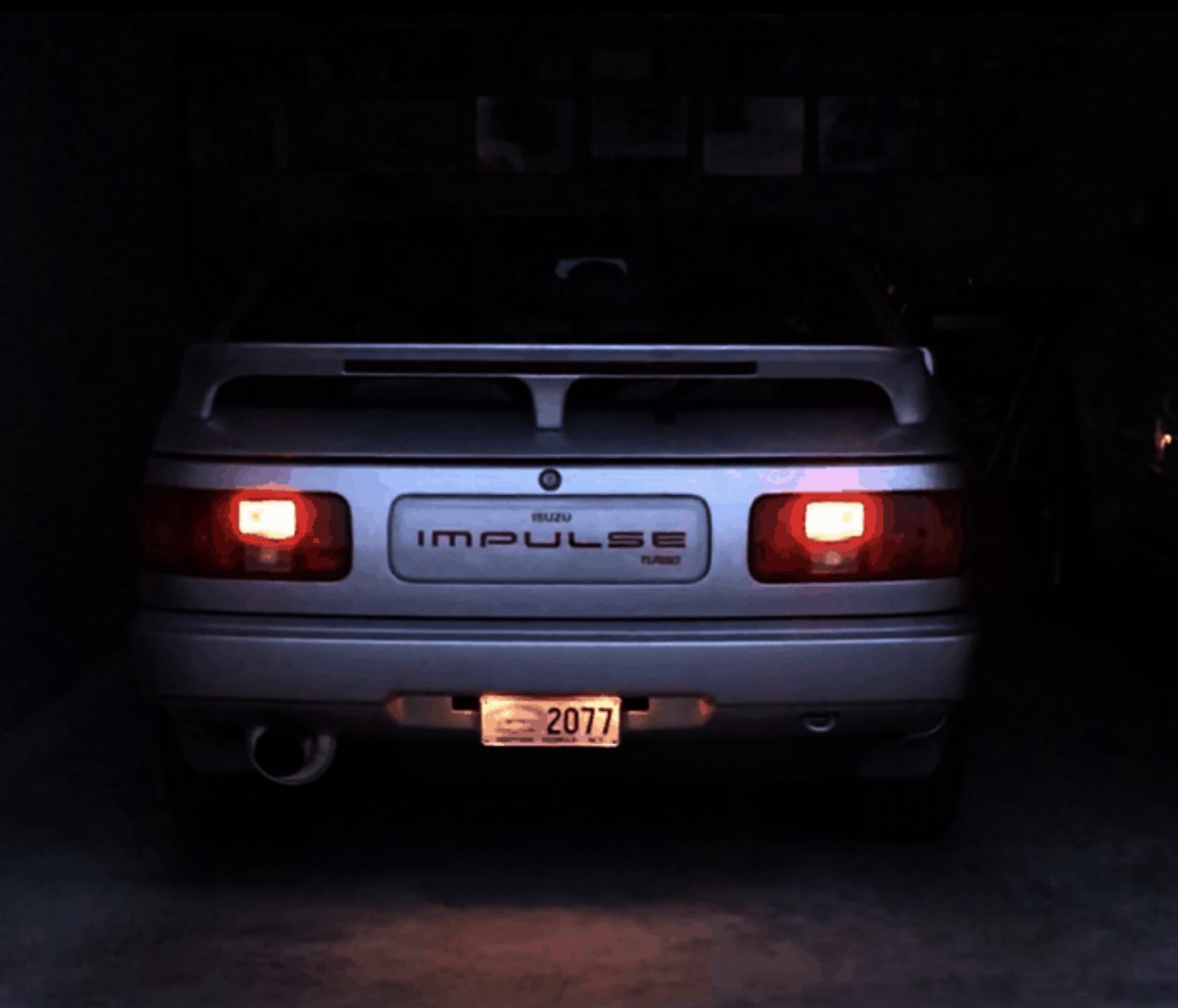

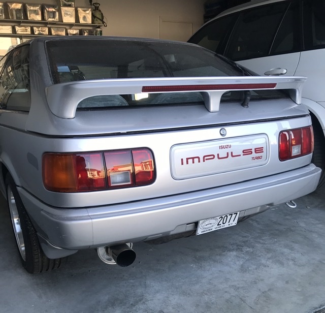

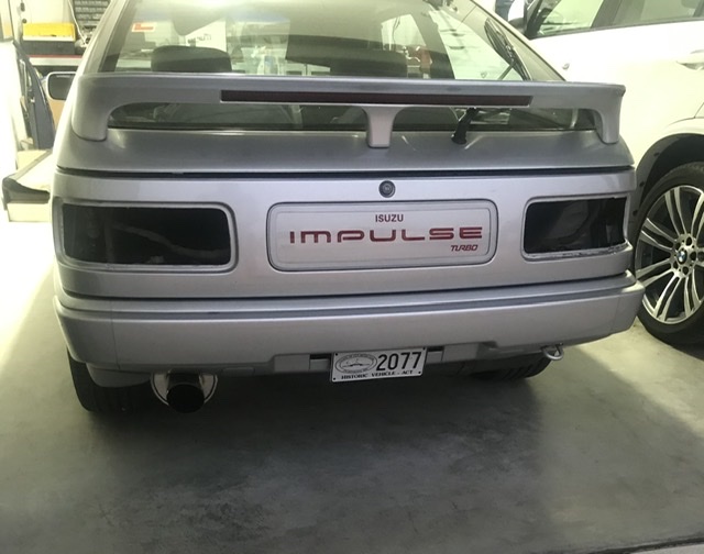

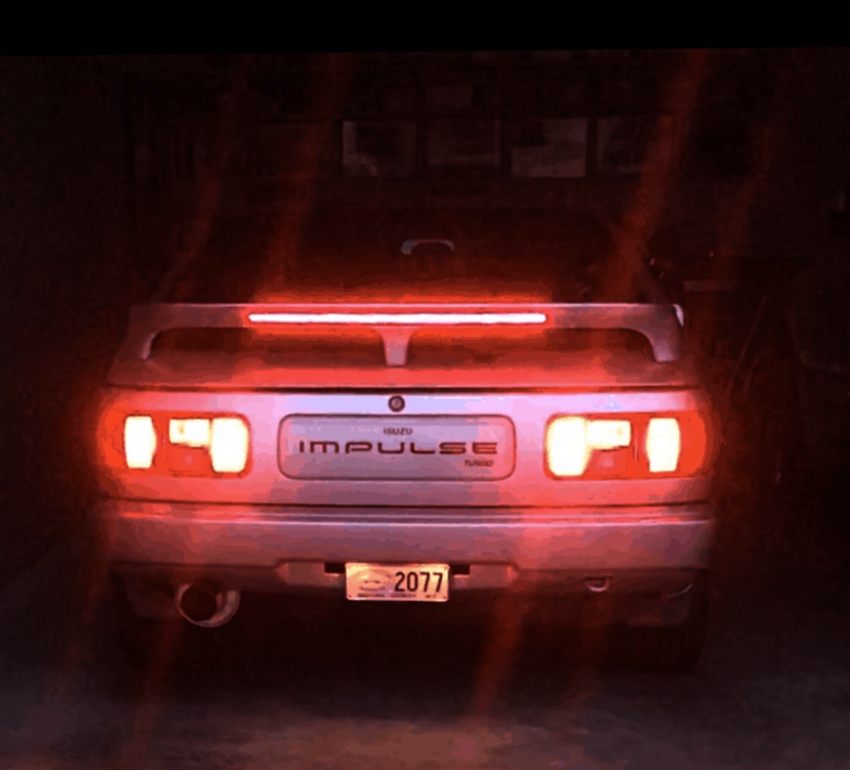

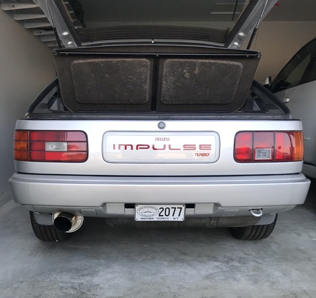

Just installed the HBL ‘88+ rear tail lights on the weekend after the wiring was re jigged to suit the existing wiring harness/connector. My electrician did a top notch job soldering on the delicate flexi-ribbon tapes and reconfiguring the wires out from the new clusters. Hot glue was then poured over soldering area to strengthen and protect the wiring.
In short, the swap-over wasn’t a plug-and-play setup. Thanks also to Thomas who gave me the heads up on the resistor/capacitors possibly overheating and causing a fire, I had that part disabled. The resistors and capacitors are used to send the appropriate warning signal back to the dashboard for any broken globes. On the original lights there were resistors and capacitors on both sides. On the later HBL versions there was a much larger resistor and heaps of resistors on the left-side tail light cluster only. This means the right-side cluster is somehow bridged/connected to the left side on the later +’88 models for proper communication back to the dash. I couldn’t risk there being a potential overheating/fire issue so I had that function disabled. No big deal in my opinion. Just maintain a visual check every now and then.

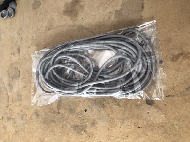

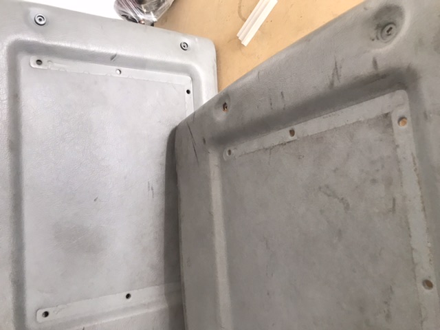

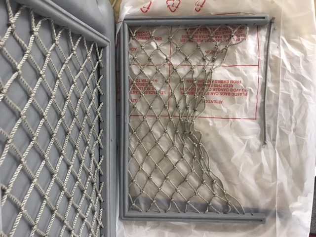

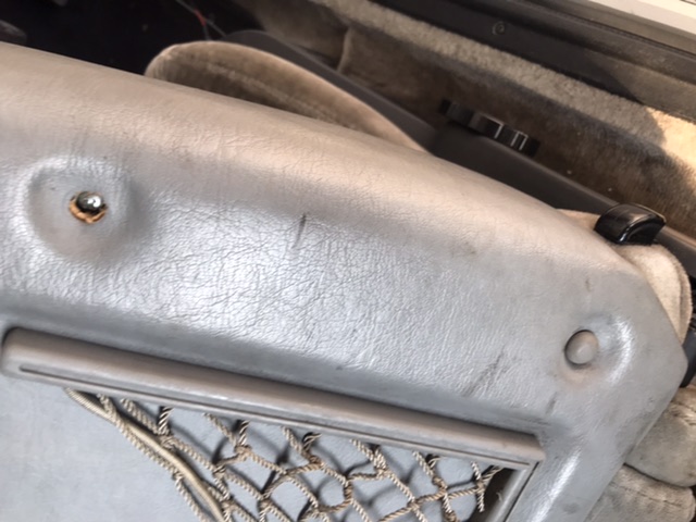

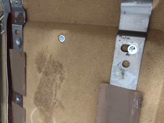

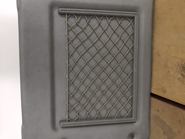

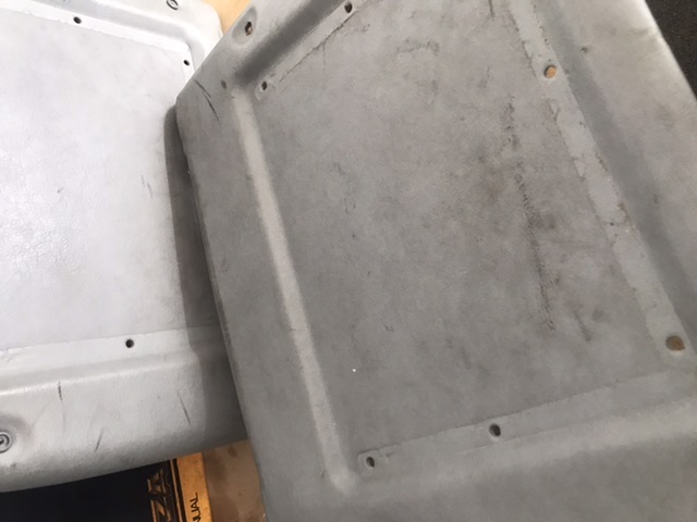

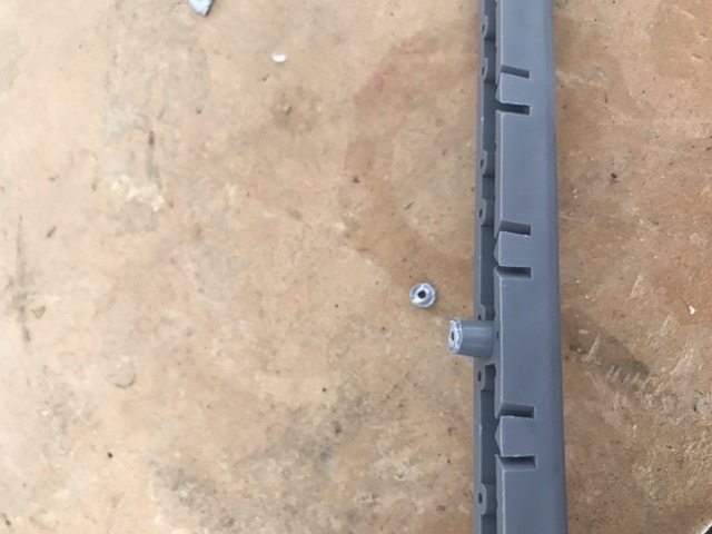

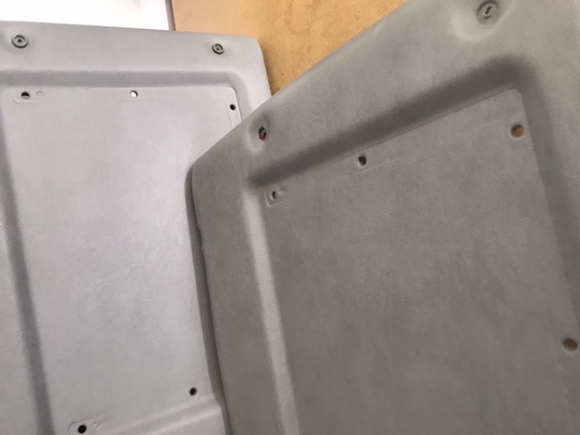

Next on the ‘to do’ list is fix the saggy sorry-looking mesh storage compartments behind the front seats. It’s obvious the offending elastic cords are perished and need to be replaced.

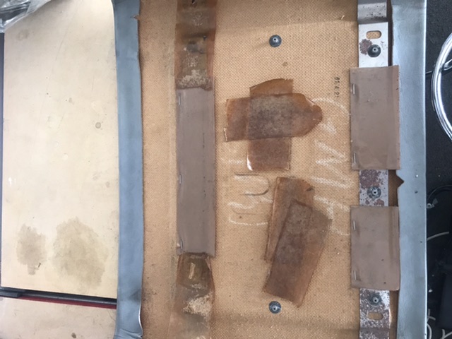

Easier said than done because the rear cover panels have to to be removed in order access the fixings to the mesh storage compartment assembly. Apart from unscrewing the rear covers you’ll also need to remove the lumbar adjustment dials and lever, all of which secured with circlips along the shaft of the dials and lever. So don’t bother trying to remove what appears to be caps at the top the dials. They aren’t real caps!
After removing the covers from the front seats you’ll find that the mesh compartment assemblies are secured by a number of small spring steel one-way clips that are designed to secure properly only once. Removing the clips pretty much buggers up the little soft plastic fingers that the clips grip onto. But that’s ok because there’s a better solution which I’ll explain later. The original spring steel clips won’t be needed anymore. The perished elastic cord was replaced with new 4mm grey cord sourced online from Etsy. I have plenty left over so if someone is interested they can let me know and I’ll post it. But if you prefer to buy it yourself it costs about $6 to ship it from China anyway. (https://etsy.me/2QM7KVe select colour number 3 if you’re after the original look). I went ahead and cleaned the covers, and washed the mesh in the washing machine. The covers looked way more dirty and scuffed after having a closer look at them on the bench. Covers were thoroughly cleaned. The amount of new elastic cord that I used per side wasn’t much at all. The little plastic fingers that poke through the back of the covers were trimmed down about 4mm with a Stanley knife, or enough so that they sit flush with the inner surface (back edge) of the cover. I then used little 4G x 6mm screws and small washers to secure the assembly down. Take extra care and do not over tighten, as the plastic is soft. The end result looks perfect. No more saggy storage compartment. The grey colour of new cord was also spot on in keeping with the original look I was after.

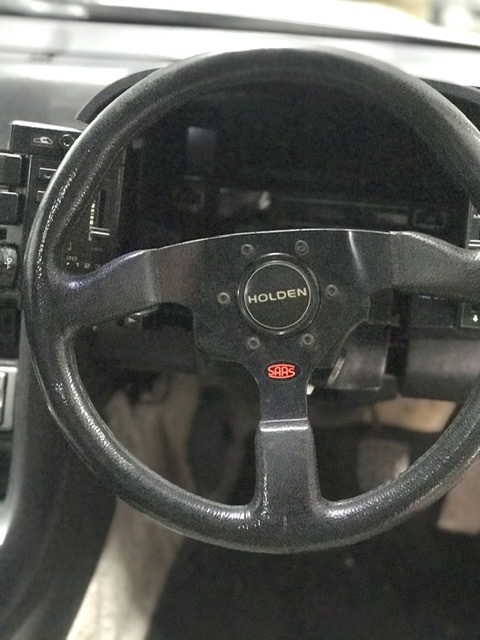

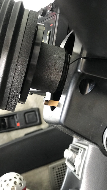

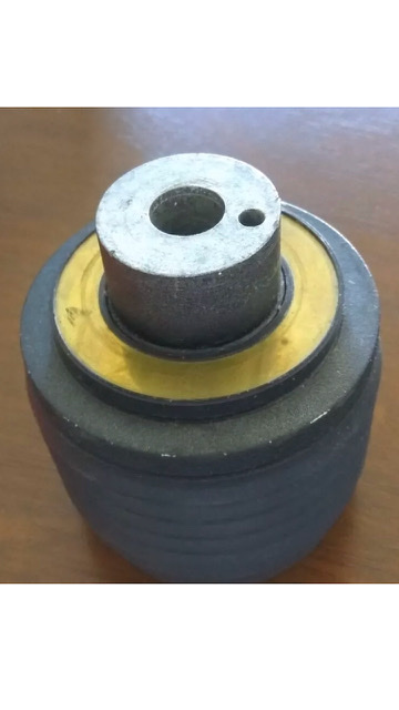

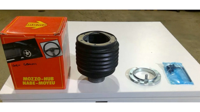

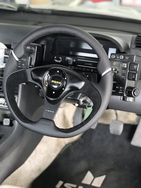

Next up. Change over the crappy SAAS steering wheel.

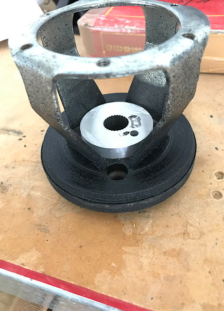

Changing the wheel wasn’t straight forward because the boss kit needed to be changed too. Finding a Momo boss kit for a Piazza proved a challenge because they stopped producing them years ago. Doing some digging around on the DUB DUB DUB and was able to find the part number which is #4600. It then took a while before a used one popped up on eBay, and then another one (brand new) on eBay a month or so later. So I bought both of them. Both boss kits had the stamping C 4600. Incidentally, the used boss kit came off an old Isuzu Chevette from Uruguay.
I figured this was of no significance, but as Giorgetto Giugiaro later pointed in my correspondence with him, they are actually for the later HBL Piazzas. They do fit the pre-HBLs like our Aussie Piazzas too in terms spline and shaft size etc, but the horn contact ring sits about 20mm away from the original contact point.
But it so happens the horn contact ring can be repositioned easily, so I araldited the ring to where it makes contact. Problem solved! Steering wheel and horn button was then fitted. All good. Much happier with the new look.

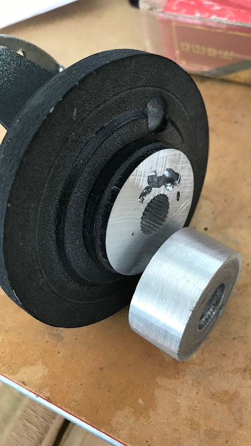

On a seperate note I played around with the second of the C 4600 boss kits. On this one I cut down the shaft ‘snout’ 19mm with a hack saw and placed the cut bit inside the boss to maintain the height of the snout (but in the other direction). Interesting to note the size of the air bubble in the casting after cutting it open. I haven’t installed this boss kit to see how well it fits down the steering shaft spline, but I will one day. But for now I’ll put it in storage.
