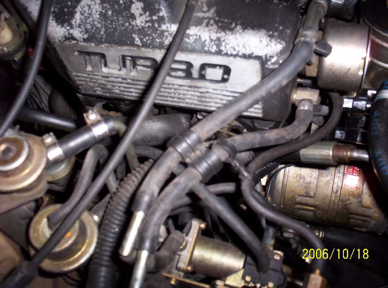

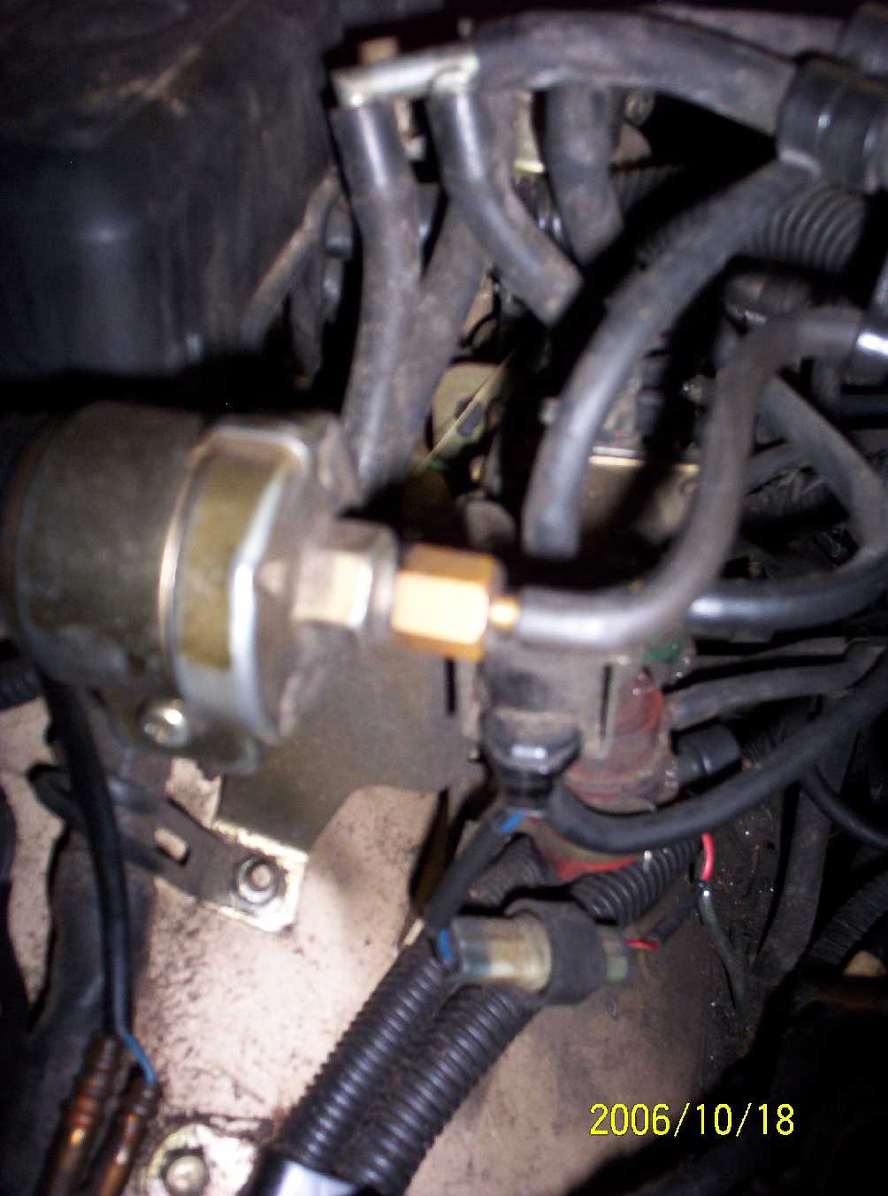

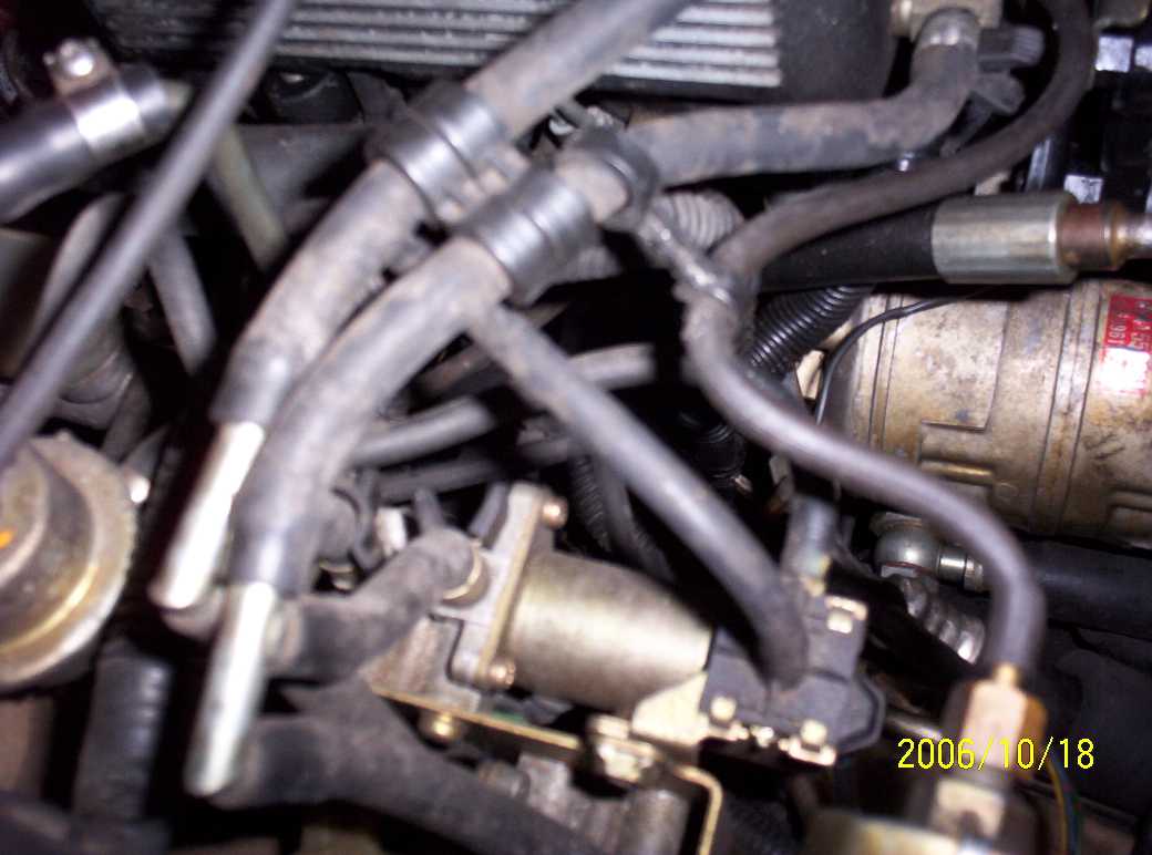

Wedgy is that round gold coloured thing in the photos with a single vac line the MAP sensor for the factory analog dash boost/vac gauge? Mine has a switch valve thingo there instead I assume to light up the lil turbo diagram on the dash if it overboosts.
hehe that's an easy one to figure out just pull the line off it and if the gauge reads atmospheric that'd be what it is.
Also yours doesn't have cruise control or road speed variable windscreen wiper? The cruise actuator and wiper computer sit in that area.. Jap spec sux dunno what i'd do without my road speed wipers
I'm bloody glad I don't have those things. The last thing I want on my electronic nightmares are even more friggin gadgets, anyway, it doesn't rain here and it is so bloody hilly that the cruise control computer would burn out trying to cope with all the elevation changes. I use the old fashioned method of my foot to maintain road speed...and it works without computers, wires, solenoids or switches LOL.
