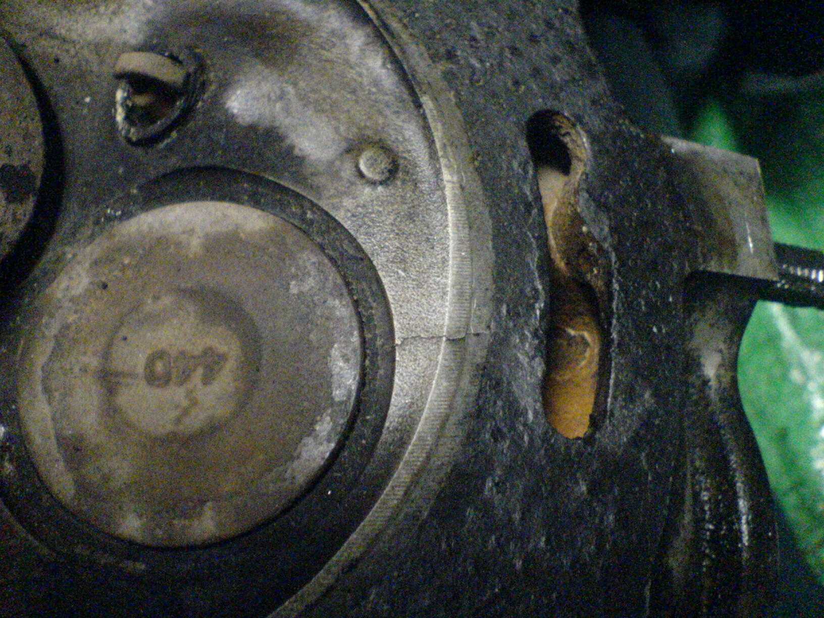

Latest thing to happen to my Piazza is a cracked head which finally caught up with me a week ago. For those of you that saw my dyno results in another thread on this site, you would have seen that running over around 10psi with the standard setup makes it run really lean throughout the rev range. Well, I found that out after I had mine turned up to 14psi for around 6 months. I quickly turned it back when I had it dyno'd. Anyway, the lean running over that period is the cause of the crack in the head next to the exhaust valve in cylinder 2. I was lucky to be driving on it so long with the crack slowly opening up for about 6 months, however the crack finally became too big and I had water mixing with oil.
Everyone who wants to run over 10 psi boost with the standard setup should read this.......dont do it!!! This is the result:

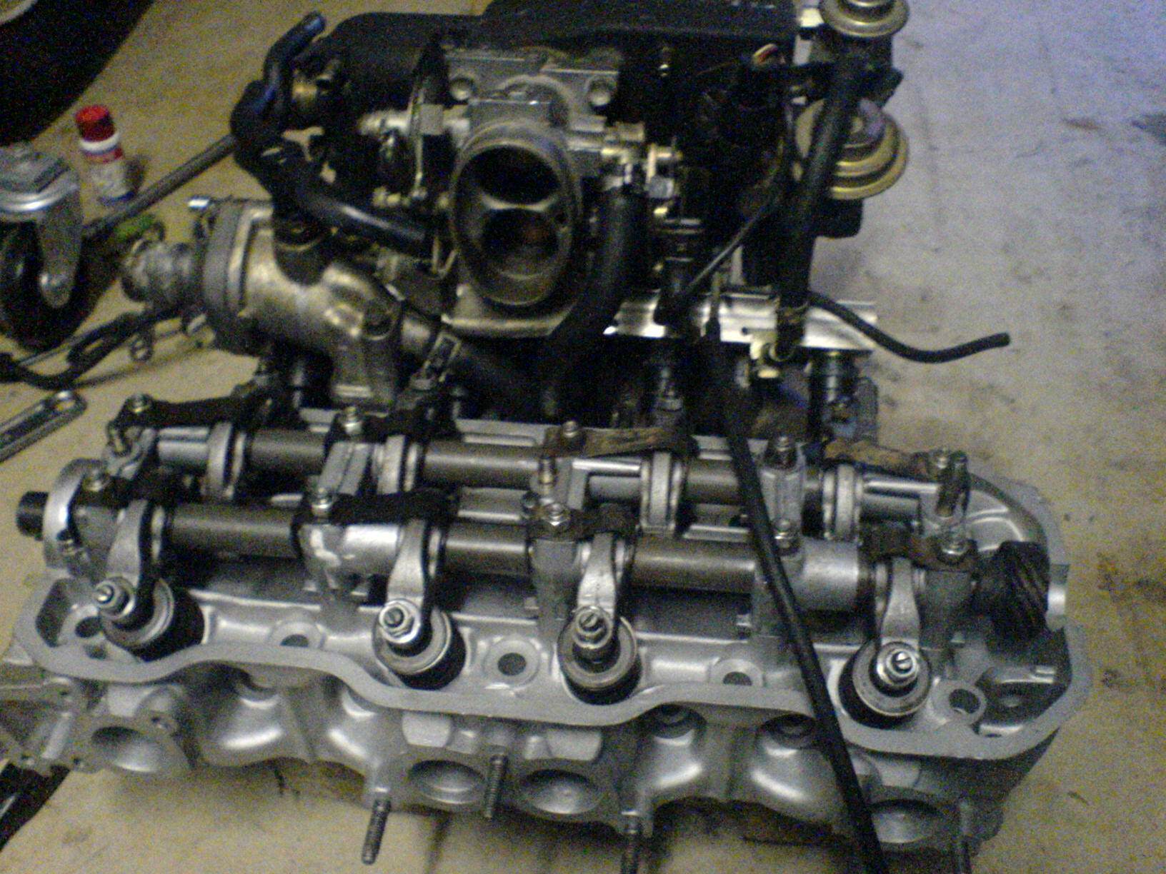

However, this hasnt all been bad as it has given me an oppurtunity to get the Rodeo runners and injectors on the new head ready for the Motec. Nearly have all the sensors I need for the Motec, just need to mount it and start wiring it up which is all straight forward. I will be using the single throttle from the Rodeo when I get the Motec up and running, but for the time being I am running the Rodeo runners (which are a fair bit larger in diameter) with the Piazza plenum and throttle body. Heres a pic of the manifold with my new reco'd head. This should be going back on the block tomorrow night hopefully!!

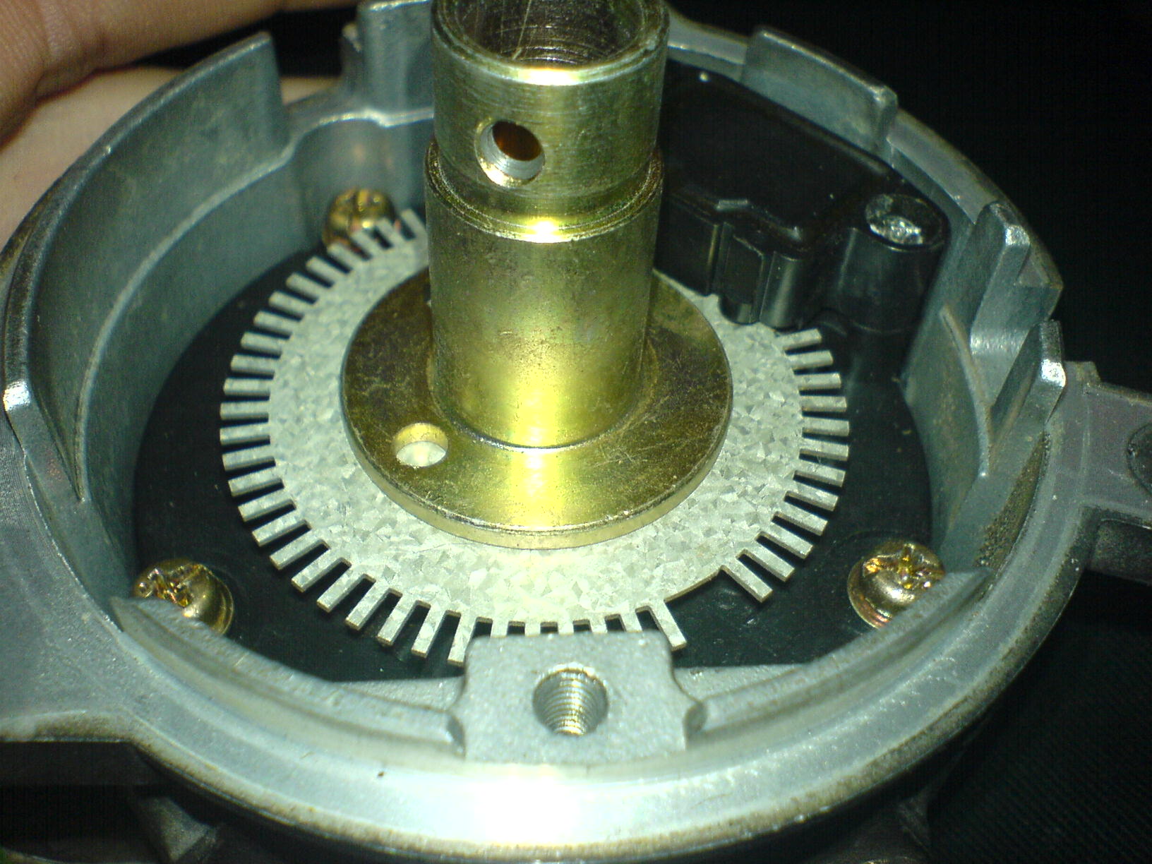

As far as the ignition side of the ecu setup goes, I am using a Rodeo CAS with custom 60-2 trigger wheel, this integrates well with the Motec and is simple to setup, not to mention bolts straight in of the original distributor.

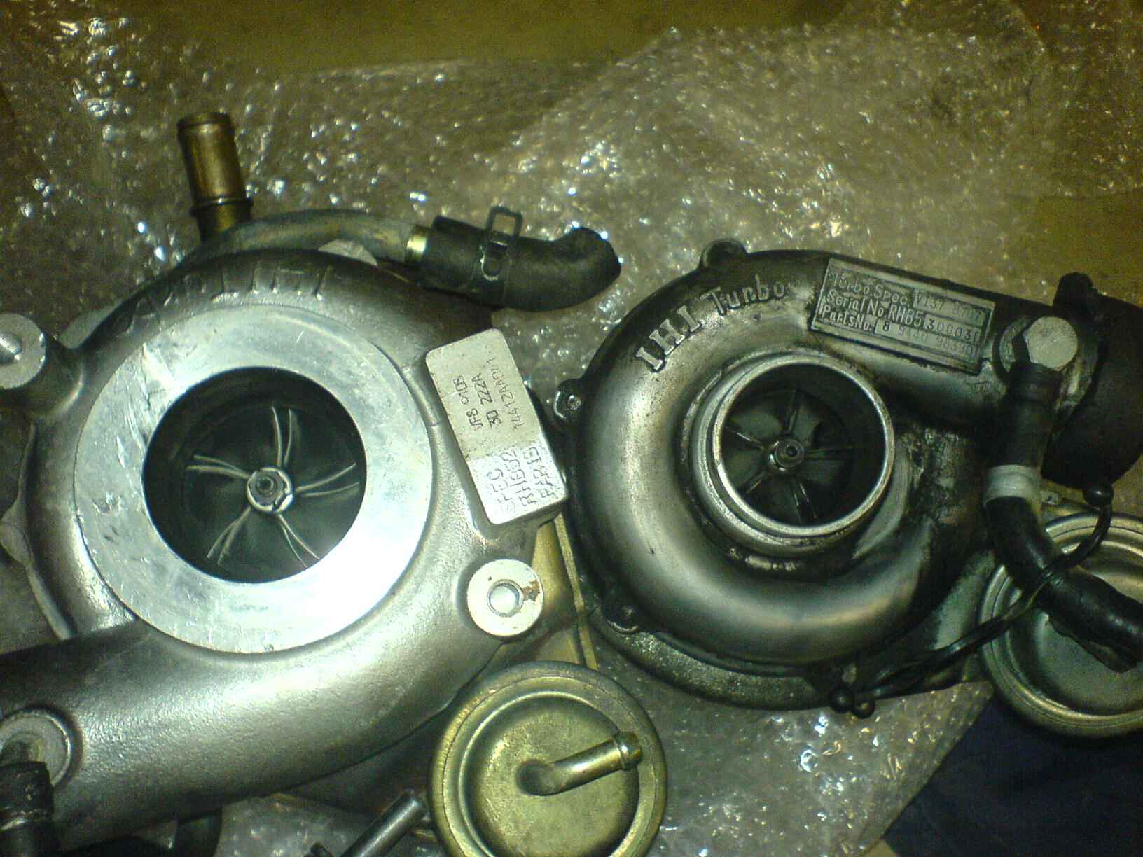

The turbo I have for the upgrade is a VF8 from a Subaru Liberty/Legacy, its a fair bit larger that the Piazza one, flows enough for around 280HP and bolts straight in place of the old one with some minor mods.

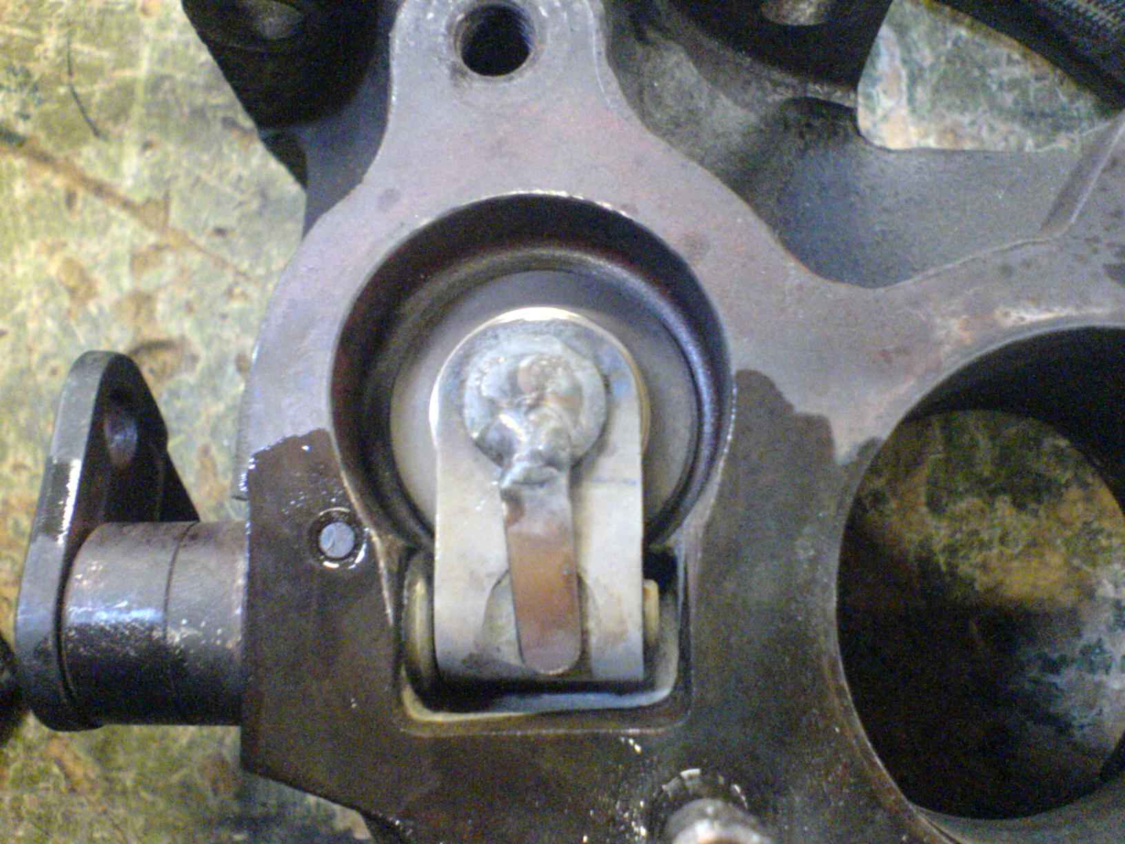

The turbo has a flange that bolts to the front cover with a gasket in between, not the best setup but thats how they did it. I am modifying the flange to fit with the piazza piping.

The head could have cracked for any reason. I wouldnt put it down to the leanout. Its possible but i wouldnt say entirely to blame.

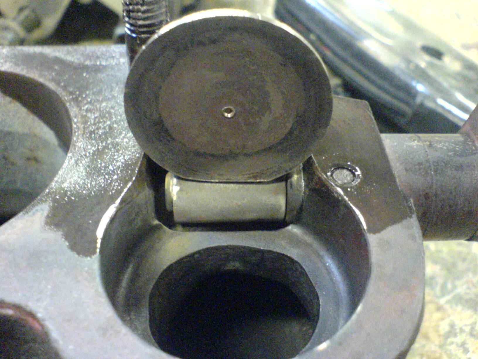

I agree you could never be 100% sure on the cause of the crack, however, I had the head off about a year ago and looked over it and it was running perfect back then. The problems started happening a few months after I turned the boost up, small bubbles started appearing in the water and the car would run on 3 cylinders at start up until the water cleared out. It was pretty conclusive to me that the head had started to crack and I was lucky that it held in there for so long. That together with the fact that the crack is on the exhaust side (the hotter side, especially when running lean) and on the edge of the bore (area prone to detonation affects) is why I am blaming the lean situation under high boost as the reason for the crack.
The turbine wheel is very similar to the Piazza one, the compressor side is totally different. The Piazza turbine housing does fit staright onto the VF8 but the VF8 has a 25mm wastegate, the Piazza a 20mm.

use the piazza ex turbine and shaft they are almost the same the subaru shaft is about 3mm shorter
slip them into the vf8 housing and use the piazza ex housing
presto strange but true
ive got a crack in my wastegate housing common ive heard
i have the wastegate jammed shut and am gettin 10-11 psi in the manifold crude but works

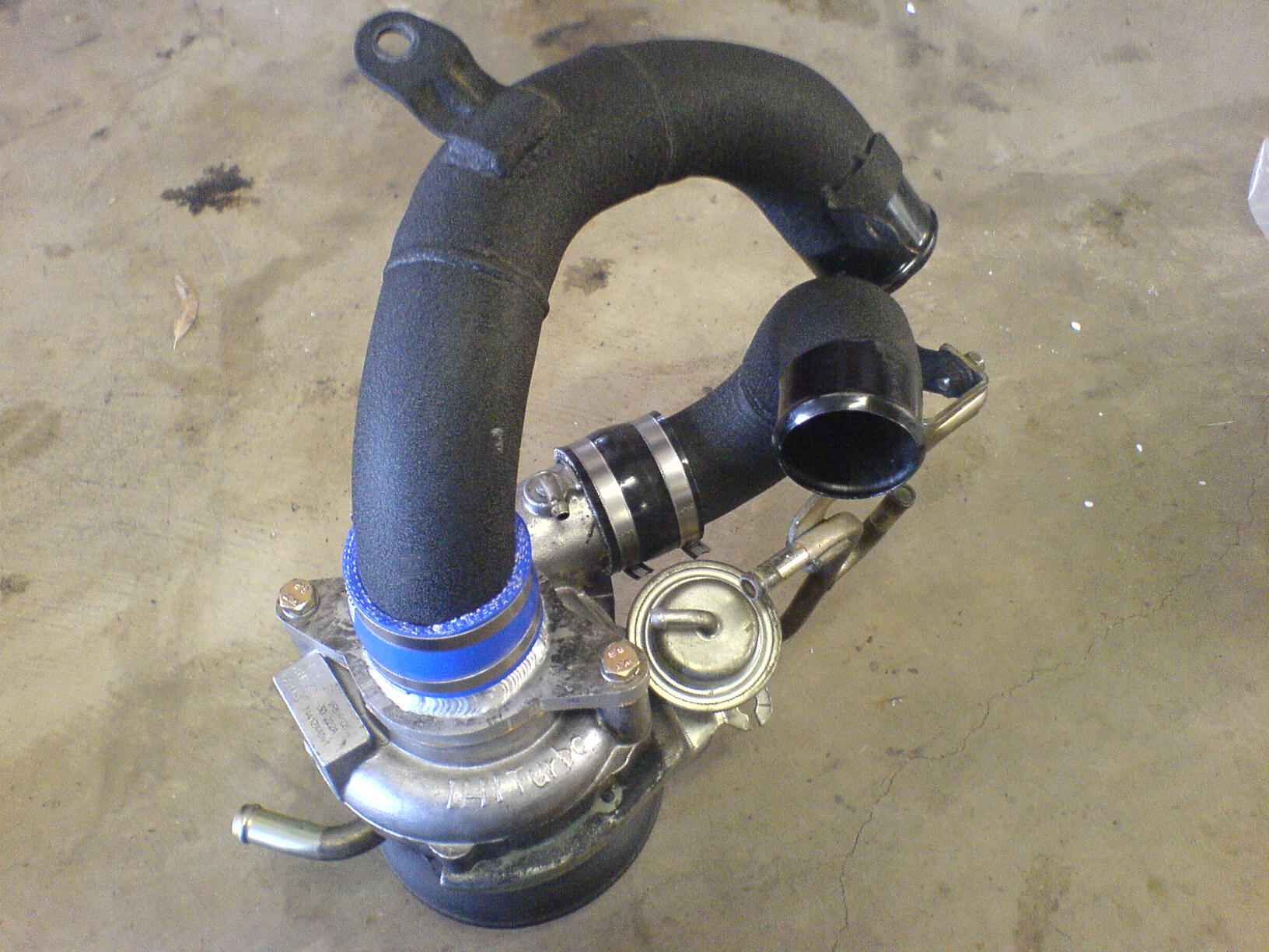

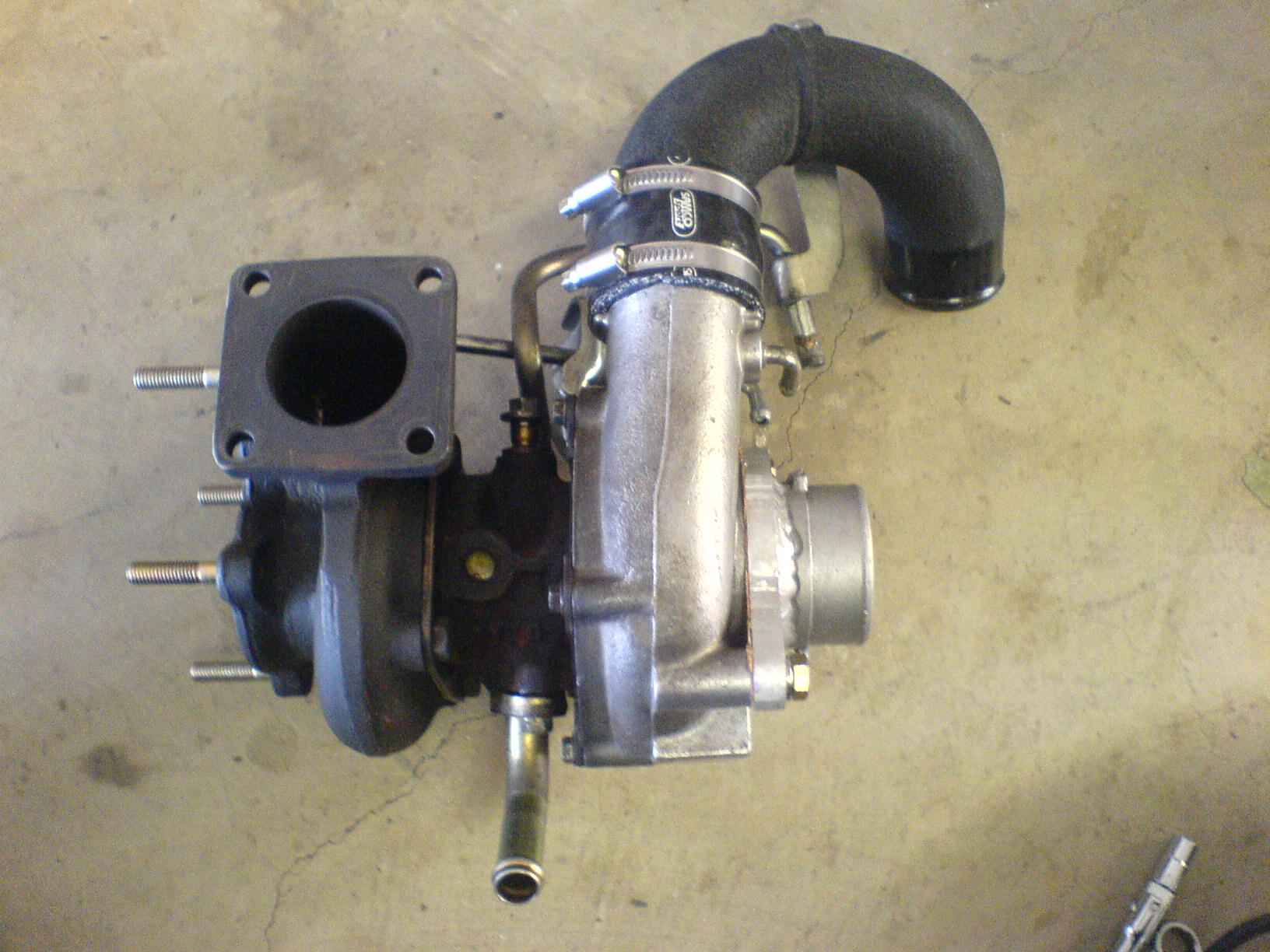

VF8 turbo is now on the car. Havent pushed it yet because I am afraid that it may be running lean. Going to put an adjustable fuel regulator on it tomorrow and crank some pressure into it to be on the safe side. Here's some pics of the turbo and wastegate mods.

I havent actually driven the car properly yet. I have been driving around at quarter throttle everywhere cause I dont want to risk running lean under load and cracking another head. Been there...done that. I am going to the dyno on Thursday to check mixtures. The turbo doesnt seem to have any more lag, in fact I think it spools up earlier. When I pulled my old turbo off I found that the water outlet banjo fitting was clogged up with crap and there was no water flowing through the turbo. This may have attributed to my turbo running a bit hotter and therefore the lag might have been more pronounced. I think once the Motec goes on and I get a good tune into it it will be a really torquey setup and my aim of this project is to have a good daily driving setup. The turbo is good for around 200kw at the motor so somewhere around that is the aim by the end of it.
