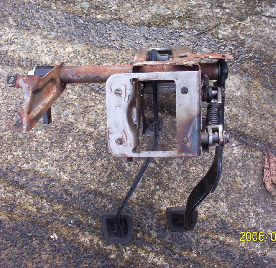

Im stuck trying to take the pedalbox out, for the life of me i cant find all the bolts holding it in. Anyone got a picture or better yet a Diagram of how it goes in?

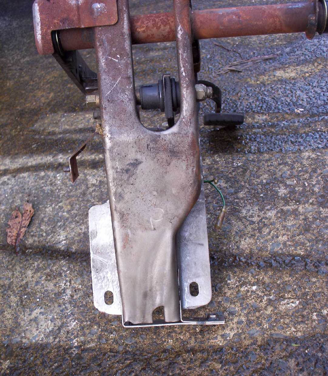

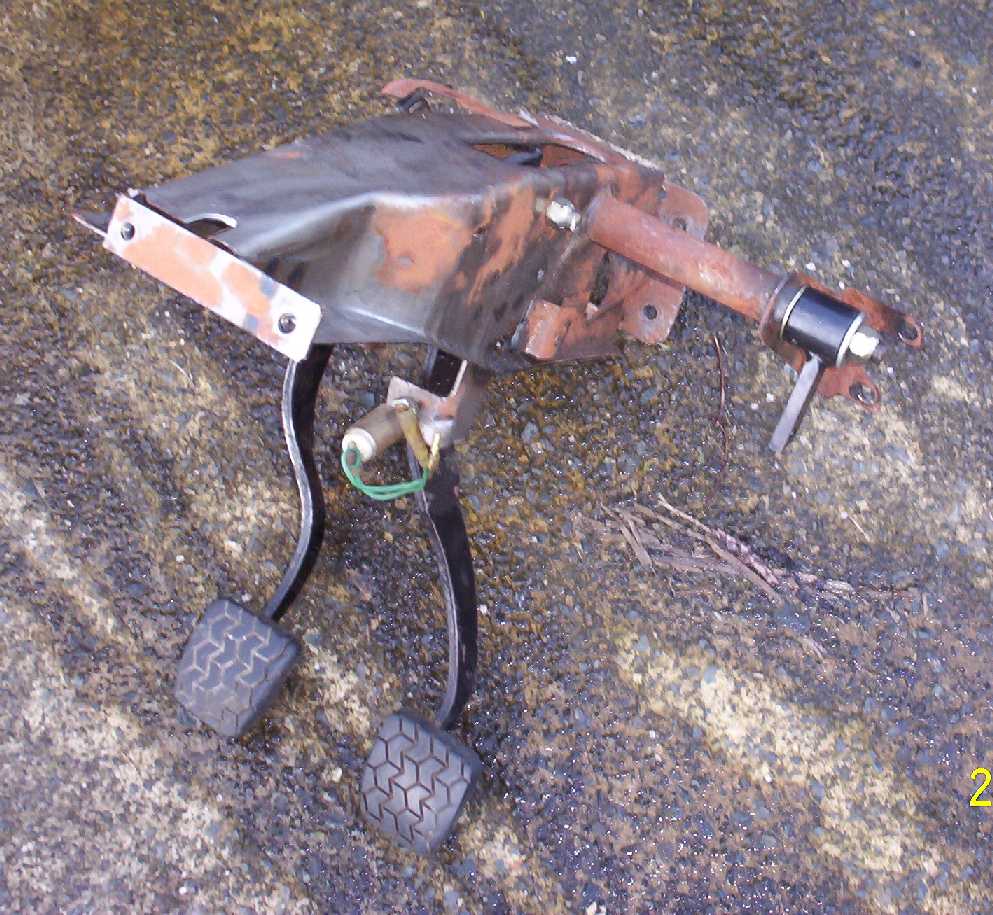

Here are some dirty pictures for you, you can see that apart from the four around the base of the column there are a couple at the dash end which you have probably got sussed. The sneaky ones are the two hiding up on the right hand side and you can't see them easily until you have the ECU out and a few things wrestled out the way. I had to change the clutch fulcrum on mine and did it in place. NEVER AGAIN. Easier with it out.
Having trouble up loading so will email to you instead
