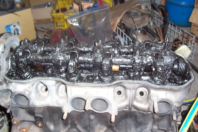

Bit of progress, both motors are out and ive started fixing the headgasket.
You can really see the milkshake on the pic above, below is with the cam cover off and the head, rocker arms etc look pretty fucking good/clean, which is always a welcome sign.
Dumb wog working on it [thatd be me]
Its just a matter of getting the head checked out now, then bolting it back on. Got most of the manual stuff out for the conversion so im getting there slowly-slowly. Now i had a stupid thought yesterday...matt black engine bay "just in case". What do you think?

Milkshake????
Is that off the motor in the red car???
The milkshake could just be from condensation. The motor has been sitting around and hasnt been driven/run long enough to evapourate the moisture out of the rocker cover for ages, like over 12 months.

Yeah that is the motor of the red car, and nah it hasnt really sat there its been started regularly and ive taken it for the odd blat every now and then. Im pretty sure its a headgasket as it only started milkshaking after i changed the coolant. Im guessing the dickhead before me did the dirty on me by filling it with ChemiWeld, couldve also been part of the reason why he was selling it. Yeah yeah i got ripped big time. Young and stupid i guess. Either way even if the headgasket is fine it only cost me $100 and better to do it now then *think* its condensation and find out otherwise.
Im rapt at how clean the top end looks. Its abit early to say just yet, but thinks are looking good.
